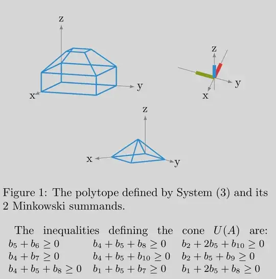

I'm trying to understand some mathematical operations and definitions for my project. Could you explain the meanings? $P_b =\{x∈\mathbb{R}^d : Ax≤b\}$ is a polytope. Let's have a 10x3 matrix $Ax≤b$
$$ \begin{bmatrix} 0 & 1 & 1 \\ 1 & 0 &1 \\ 1 & 0 & 0\\ 0 & 1 & 0\\ 0 & 0 & -1 \\ 0 & 0& 1\\ 0 & -1& 0\\ 0 & -1& 1\\ -1 & 0& 0\\ -1 & 0& 1 \end{bmatrix} \begin{bmatrix} x_1\\ x_2\\ x_3 \end{bmatrix} \leq \begin{bmatrix} 4\\ 4\\ 3\\ 3\\ 0\\ 2\\ 0\\ 1\\ 0\\ 1 \end{bmatrix} $$
Let us denote the set of such right hand side vectors $b$ by $U(A)=\{b∈\mathbb{R}^m : P_b \neq ∅\}.$
Switching from the H-representation to its V- representation, the cone U (A) is generated by 9 rays and 3 lines in $Z^{10}$. The normal cone of a face F of a polytope P in $R^d$ is the set $N(F;P)=\{v∈\mathbb{R}^dd : v^⊤x=h(P,v)~for~all~ x∈F\}.$ The dimension of the normal cone of a $k$-dimensional face is $(d − k)$. The normal fan $N(P)$ of $P$, which is the collection of the normal cones of all faces of $P$ , is a complete fan in $\mathbb{R}^d$.
I have difficulty in understanding of the terms. So, what is the exact meaning of $U(A)$ here? What are the $b_{1,2,...}$ letters and how obtained? How is the 9 rays and 3 lines expression written? Can you explain also meanings of normal fan,cone and complete fan?

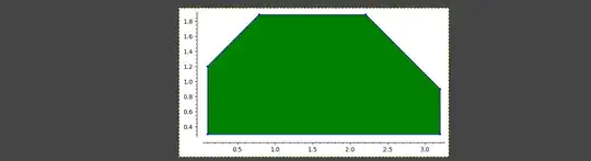

sage: P.show()
Here, sage uses $x$ instead of $(x_1,x_2)$. Yes, the picture shown is
picture_2d_001

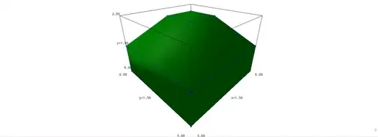

sage: P.show()
Launched html viewer for Graphics3d Object
Then i get the image in the browser. It is a 3D-image, and we can rotate it.
picture3d_002

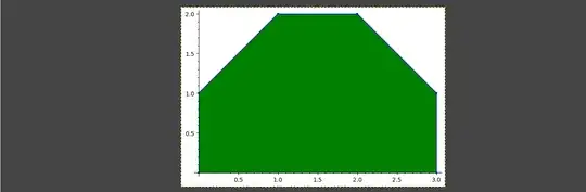

Imagine we change the two $x$-conditions, and the two $y$-conditions, and the two remaining conditions "slightly". $$ \left\{ \begin{aligned} -x & \le 0\ ,\\ x & \le 3\ ,\qquad\text{ so }x\in[0,3]\\ -y & \le 0\ ,\\ y & \le 2\ ,\qquad\text{ so }y\in[0,2]\\ -x+y & \le 1\ ,\\ x+y & \le 4\ . \end{aligned} \right. \qquad\text{ into }\qquad \left\{ \begin{aligned} -x & \le -0.1\ ,\\ x & \le 3.2\ ,\qquad\text{ so }x\in[0.1\ ,\ 3.2]\\ -y & \le -0.3\ ,\\ y & \le 1.89\ ,\qquad\text{ so }y\in[0.3\ ,\ 1.89]\\ -x+y & \le 1.1\ ,\\ x+y & \le 4.1\ . \end{aligned} \right. $$ Then the corresponding picture is:
picture_2d_003
What happened? Every delimiting line was "slighlitly" moved parallely to itself corresponding to the deformations of the corresponding conditions. Some half-spaces are now "bigger" (w.r.t. the inclusion), other are "smaller". So chosing other $b$-values means moving the delimiting lines (in 2D, planes in 3D) in a parallel way, and then $P(A,d)$ is the new intersection of half-planes (in 2D, half-spaces in 3D) given by the new fronteers.

(8) How to see the decomposition of the house as "sum" of some pieces?
Let us take the (solid) "roof" $R$ only, it is in the picture Figure 1 from the link the (solid) pyramid, that roof placed on the ground.
Consider also the cube $C=[0,1]^3$. What is $R+C$?
It is the set obtained as the union of all $R+c$ for $c$ in the cube $C$. So we take $R$ and move it in all $x,y,z$ directions, at most one unit. Some points will be taken more than once in this movement. But note that the upper vertex of the pyramid can reach at most the height $2$, and in this case it can realize exactly the points on the roof platform.
This illustrates that our house is decomposed as a sum in the shape $R+C$.
Now $C$ further decomposes as the sum of elements on the three segments $[0,1]\times[0]\times[0]$, it corresponds to the red segment in Figre one, but i want the opposite orientation, $[0]\times[0,1]\times[0]$, the green segment with opposite orientation, and $[0]\times[0]\times[0, 1]$, the blue segment.
(I have to submit... almost too long to be shown, there is a limit of characters, i often hit it. For the rest, how to get the $b$-inequalities, a new post is needed. If there is a real interest, the post will be here as soon as my typing skills allow it.)
