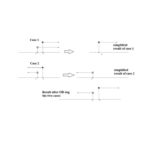

Case 1, when $x \gt 2$, we have $$x \le 3(x – 2)$$ and this gives $$x \ge 3$$ AND-ing the conditions together (See diagram below), we get $x \ge 3$.
OR
Case 2, when $x \lt 2$, we have $$x \ge 3(x – 2)$$ and this gives $$x \le 3$$ AND-ing the conditions together (See diagram below), we get $x \lt 2$.
Result follows after we combine the two cases using ‘OR’.
