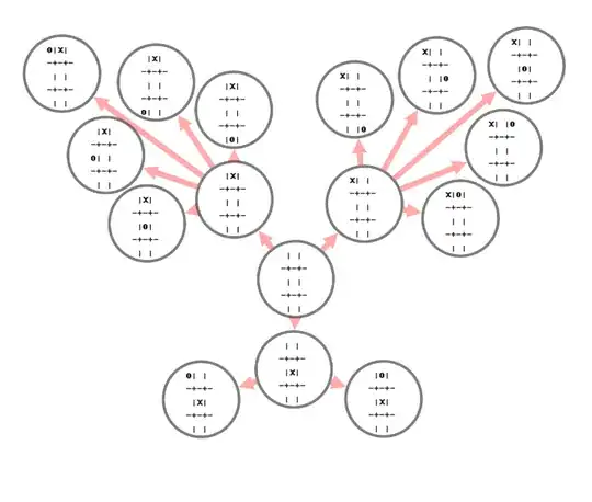

Just thought I would throw this out there, I counted 46910 total game states including non-win non-draw situations like the empty board. #pyhtonFTW
EDIT: If you assume that players will block if the opponent will win next turn and also that players will win if they can I found a decision tree with 6355 nodes, of the leaves, 488 are X wins, 1278 are draw and, 164 are O wins. (X goes first.)
That said I think I actually over did it with my checking board transformations... For each possible move I check 16 possible board orientations, and apparently I only need to check 8...
I think I could just comment out lines; 8, 9, 58, 59. enter image description here https://github.com/Krewn/TicTacToe/blob/master/ttt.py
