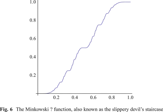

I came across an example of such a function some time ago. It is called Minkowski's Question Mark Function, and it is denoted simply by $ ? $. Minkowski defined it so that it would map the quadratic irrationals (i.e. numbers of the form $ \dfrac{a + b \sqrt{c}}{d} $, where $ a,b \in \mathbb{Z} $, $ d \in \mathbb{Z}^{\times} $ and $ c \in \mathbb{N} $ is square-free) contained in the open interval $ (0,1) $ to the rationals in $ (0,1) $ in a continuous and order-preserving manner. More precisely, $ ? $ takes the number $ x $ with the continued fraction expression $ [0;a_{1},a_{2},a_{3},\ldots] $ to the number $$ ?(x) \stackrel{\text{def}}{=} \sum_{k=1}^{\infty} \frac{(-1)^{k - 1}}{2^{(a_{1} + \cdots + a_{k}) - 1}}. $$
Minkowski ? function
According to [Salem 1943], the function $ ? $ satisfies the following properties:
  • $ ? $ is continuous on $ [0,1] $.
  • $ ? $ is strictly increasing.
  • $ ? $ is purely singular.
As such, $ ? $ is sometimes called the Slippery Devil's Staircase, as opposed to the Devil's Staircase, which is actually constant on some intervals.
