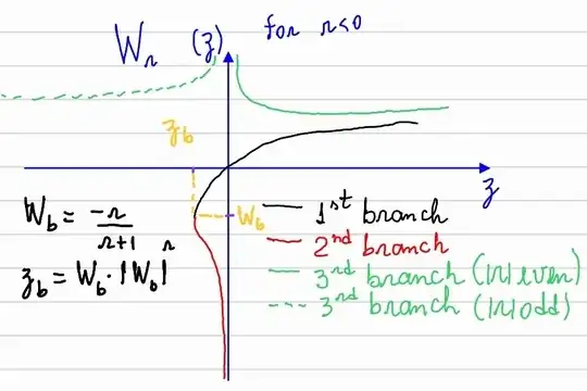

There is a second possibilty to exist $x>0$. If $s<0$ we have $r<0$ and if $W_r(z)<0$ it could have at least one possible solution $x>0$. The figure below illustrates behavior of Lambert-Tsallis function when $r \in Z_{-}^{*} < -1$.
Lambert-Tsallis function when <span class=$r \in Z_{-}^{*} $" />
The case $\mathbf{ r < -1}$ or $\mathbf{s < -1/2}$
If we look to such a figure, when the condition $z_b < z < 0$ is satisfied there are 2 possible $W_r(z) <0$ that could generate solutions for $x$ that can be written as
$$ z_b < \frac{r\cdot C^2}{A^{2r+2}} <0 $$ $$ \implies C< C_{Thr}= A^{r+1}\cdot \sqrt{-\frac{1}{r+1} \cdot (\frac{r}{r+1})^r} $$
When $s<-1/2$, you see that there is a relationship that must be satisfied if you want to have $x>0$. Let's see somes examples.
\begin{matrix} A & s & C_{Thr} & C/C_{Thr} & r & z & W & x\\ \textbf{+3.1416} & \textbf{-1/1.99} & \textbf{+0.9787} & \textbf{+0.9000} & \textbf{-1.0050} & \textbf{-0.7887} & \textbf{(-3.80307 , -0.00000i)} & \textbf{(+6.11123 , +0.00000i)} \\ \textbf{+3.1416} & \textbf{-1/1.9} & \textbf{+0.8481} & \textbf{+0.9000} & \textbf{-1.0526} & \textbf{-0.6918} & \textbf{(-2.45948 , +0.00000i)} & \textbf{(+4.80212 , -0.00000i)} \\ \textbf{+3.1416} & \textbf{-2/3} & \textbf{+0.4693} & \textbf{+0.9000} & \textbf{-1.3333} & \textbf{-0.5103} & \textbf{(-1.20217 , +0.00000i)} & \textbf{(+2.98307 , -0.00000i)} \\ \textbf{+3.1416} & \textbf{-1.0000} & \textbf{+0.1592} & \textbf{+0.9000} & \textbf{-2.0000} & \textbf{-0.4050} & \textbf{(-5.09081 , +0.00000i)} & \textbf{(+5.01220 , -0.00000i)} \\ \textbf{+3.1416} & \textbf{-1.0000} & \textbf{+0.1592} & \textbf{+0.9000} & \textbf{-2.0000} & \textbf{-0.4050} & \textbf{(-0.78573 , +0.00000i)} & \textbf{(+1.96912 , -0.00000i)} \\ \textbf{+3.1416} & \textbf{-1.5000} & \textbf{+0.0390} & \textbf{+0.9000} & \textbf{-3.0000} & \textbf{-0.3600} & \textbf{(-3.24070 , +0.00000i)} & \textbf{(+3.26519 , -0.00000i)} \\ \textbf{+3.1416} & \textbf{-1.5000} & \textbf{+0.0390} & \textbf{+0.9000} & \textbf{-3.0000} & \textbf{-0.3600} & \textbf{(-0.64650 , +0.00000i)} & \textbf{(+1.45839 , -0.00000i)} \\ +3.1416 & -1.5000 & +0.0390 & +0.9000 & -3.0000 & -0.3600 & (+12.88720 , +0.00000i) & (+0.00000 , -6.51131i) \\ +3.1416 & -1.5000 & +0.0390 & +1.1000 & -3.0000 & -0.5378 & (-1.13571 , +1.05148i) & (+2.10097 , -0.82325i) \\ +3.1416 & -1.5000 & +0.0390 & +1.1000 & -3.0000 & -0.5378 & (-1.13571 , -1.05148i) & (+2.10097 , +0.82325i) \\ +3.1416 & -1.5000 & +0.0390 & +1.1000 & -3.0000 & -0.5378 & (+11.27141 , -0.00000i) & (+0.00000 , +6.08946i) \\ \textbf{+3.1416} & \textbf{-2.0000} & \textbf{+0.0105} & \textbf{+0.9000} & \textbf{-4.0000} & \textbf{-0.3417} & \textbf{(-2.71659 , -0.00000i)} & \textbf{(+2.58900 , +0.00000i)} \\ \textbf{+3.1416} & \textbf{-2.0000} & \textbf{+0.0105} & \textbf{+0.9000} & \textbf{-4.0000} & \textbf{-0.3417} & \textbf{(-0.59515 , -0.00000i)} & \textbf{(+1.21181 , +0.00000i)} \\ +3.1416 & -2.0000 & +0.0105 & +0.9000 & -4.0000 & -0.3417 & (+9.65587 , +8.06864i) & (+1.90040 , -5.23798i) \\ +3.1416 & -2.0000 & +0.0105 & +0.9000 & -4.0000 & -0.3417 & (+9.65587 , -8.06864i) & (+1.90040 , +5.23798i) \\ +3.1416 & -2.0000 & +0.0105 & +1.0100 & -4.0000 & -0.4304 & (-1.30394 , +0.30543i) & (+1.80579 , -0.20867i) \\ +3.1416 & -2.0000 & +0.0105 & +1.0100 & -4.0000 & -0.4304 & (-1.30394 , -0.30543i) & (+1.80579 , +0.20867i) \\ +3.1416 & -2.0000 & +0.0105 & +1.0100 & -4.0000 & -0.4304 & (+9.30394 , -7.49468i) & (+1.80579 , +5.12030i) \\ +3.1416 & -2.0000 & +0.0105 & +1.0100 & -4.0000 & -0.4304 & (+9.30394 , +7.49468i) & (+1.80579 , -5.12030i) \\ \end{matrix}
