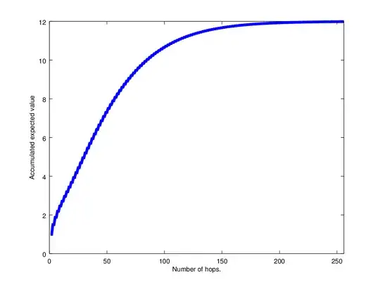

Consider the numbers 1, 2, ..., 12 written around a ring as they usually are on a clock. Consider a Markov chain that at any point jumps with equal probability to the two adjacent numbers. (a) What is the expected number of steps that $X_n$ will take to return to its starting position? (b) What is the probability $X_n$ will visit all the other states before returning to its starting position?
I can see that we simply have a doubly stochastic 12x12 matrix, with $P_x(x, x+1) = P_x(x, x-1) = 1/2$ (here assuming 12 + 1 = 1). Thus, the stationary distribution $\pi[i] = 1/12$ for all $i \in [1:12]$. Then, the expected number of steps from any $i$ to $i$ is simply $1 / \pi[i] = 12$, right?
(b) is a little trickier - we know that all states here are null recurrent. However, I'm not sure how to think about this probability. Any tips?
