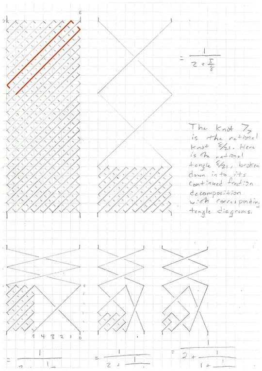

Addition
Since you asked, here is an old hand drawn example of what you asked for. The knot that we start with is $7_7$, which is the rational knot $8/21$. That means we put that slope lines on a $I\times I$ square and $-8/21$ on the back. But for graph paper, we made it slope 1 on a 8 by 21 rectangle. So the first tangle in the upper left, we get the knot by attaching the two left hand side ends of the tangle and then the same for the right. Now, we have two corresponding things happen between each picture. We modify the diagram and we modify the fraction.
To go to the next image on the top, we see that we can pull red section back to where they meet one third of the way down the image. Then we can repeat this for all the rest of the arcs to get until just the arcs meeting the two top corners are left. Similarly, we can just repeat this whole process for the middle one third, to arrive at the second image.
For the fraction, we use partial fraction decomposition to see that $$ \frac{8}{21} = \frac{1}{\frac{21}{8}} = \frac{1}{2+\frac{5}{8}}$$ The 2 represents the two whole squares we isolated that only have 1 crossing each.
Now, we repeat the whole process but with $\frac{5}{8}$ and all the rest until we get only ones in the numerators and the tangle decomposes to last image in the bottom right and the partial fraction decomposition (which got cut off) should be
$$\frac{1}{2+\frac{1}{1+\frac{1}{1+\frac{1}{1+1/2}}}}$$
To go from the last image to the square tower (like figure 2 in Hatcher and Thurston's paper) you use a planar isotopy which is shown in Figure 8 of Kauffman and Lambropoulou's paper.
