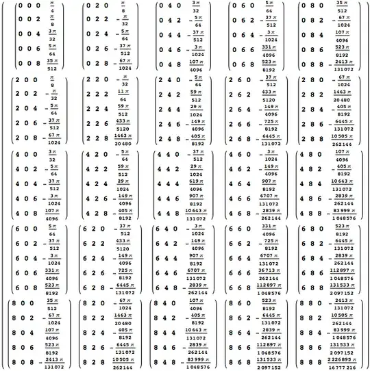

Update
My guess seems to be wrong. Symbolic integration for the first $8\times8\times 8 $ values of $(n_1,n_2,n_3)$ yields (with $k_1=k_2=k_3=1$)
graphics

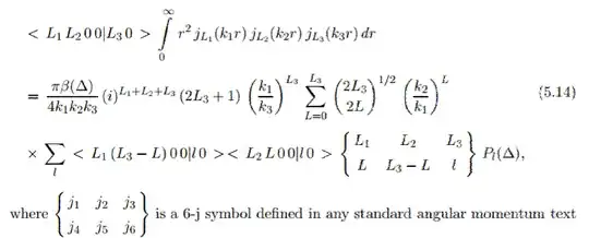

R. Mehrem gives this as equation 5.14 in the paper The Plane Wave Expansion, Infinite Integrals and Identities involving Spherical Bessel Functions (arXiv:0909.0494v4). It looks like this:
Mehrem paper screenshot
The symbols in curly braces are Wigner 6j-symbols, and the angle-bracketed letters are Clebsch-Gordan coefficients. The P_l is a Legendre polynomial, and Delta is k1^2+k2^2-k3^2/(2k1k2), coming from applying law of cosines to a triangle in k-space (it is just cos theta_12)). The beta function is zero unless the k1, k2, k3 combination is such that it forms a closed triangle (i.e. the side lengths satisfy the triangle inequality).
