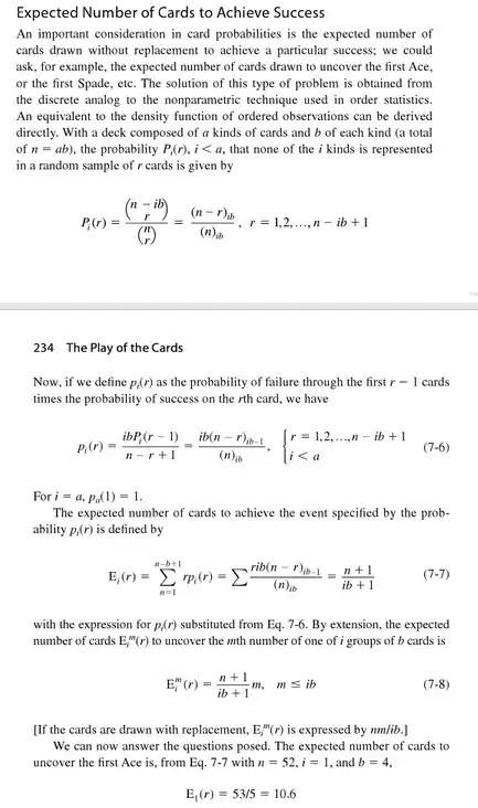

I came across this in The Theory of Gambling and Statistical Logic By Richard A. Epstein so pasting a snippet here. I got this from Google Books (public domain) so hopefully there is no copyright violation here. It's amazing how Andre, Michael and Patrick derived the correct answer differently.
