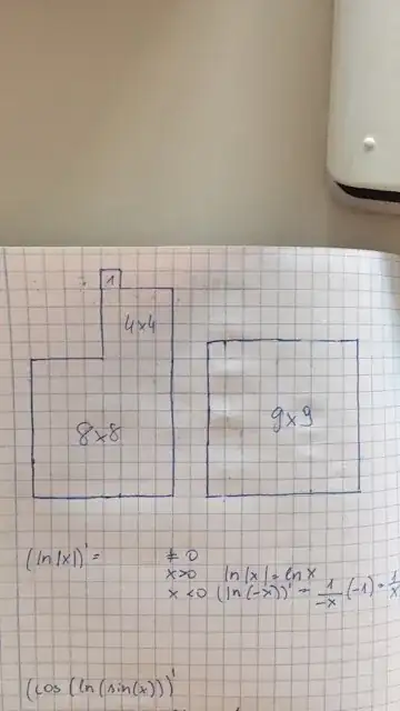

I have a puzzle which I just cannot solve. I attached a photo of it. The task is to transform the shape on the left into a 9x9 square (on the right) using ONLY 2 "cuts" - dividing it into 3 separate objects. Mirroring, rotating of them is allowed. You do not have to cut in a straight line, creating zig-zags, etc. is allowed. (please ignore the random functions at the bottom). Do you have any suggestions or potential solution? Thank you very much!

  • Almost got it for $2$ cuts into $4$ pieces. Are we sure this has a solution? https://i.imgur.com/eloJmXV.png – Jam Oct 01 '17 at 21:20
  • Thank you for your effort! It was given as an extra task for bonus points at my friend's university - prof claimed that there is a solution but it cost also him a fair amount of time. So I am pretty sure there is a solution. – David Kosztyu Oct 01 '17 at 21:36
  • Ah, I see. Thanks for explaining where the problem came from :) It's kind of a trivial point but the right side edge of the shape is $>9$ so one cut has to end on the right side edge. – Jam Oct 01 '17 at 21:51

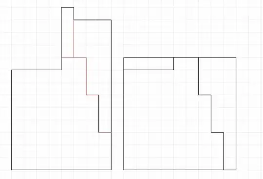

  • I can come up with $2$ ways of doing it in $5$ pieces but nothing better, yet. https://imgur.com/qnI99hg https://imgur.com/cs9qUeL – Jam Oct 01 '17 at 22:24
  • Another one with $5$ pieces. https://imgur.com/k2mhAi2. – Jam Oct 01 '17 at 22:54
  • This paper https://web.cs.umass.edu/publication/docs/2011/UM-CS-2011-028.pdf gives an algorithm for computing the dissection. I think I've almost got it with $3$ pieces: https://imgur.com/thtxeSM – Jam Oct 01 '17 at 23:41
