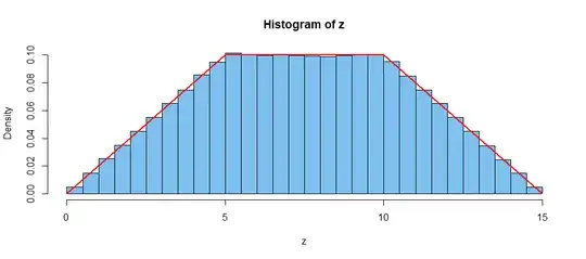

Comment (outline and visualization): For $\alpha = 5,\,\beta = 10$ here is a histogram (blue bars) of a large random sample from the distribution of $Z,$ showing @kimchilover's trapezoid. The joint distribution of $X$ and $Y$ is the uniform distribution over a rectangle with density $f_{X,Y}(x,y).$ When you work out the limits on the integral (split into three parts) in @spaceisdarkgreen's Comment, you will get the PDF of $Z$ (red line).
