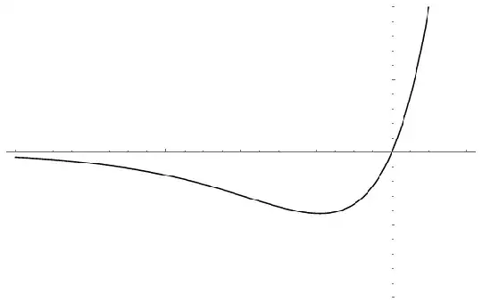

This does not really help, as the right side contains infinitely many coefficients itself. And infinitely many must be non-zero. I expect that a possible solution looks something like this:
