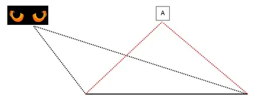

Just a hint, maybe of some use.
The point source emits a cone of light, and the intersection with a plane perpendicular to the cone axis is indeed a circumference.
Imagine you are just above the spot, you somehow manage (transparent ceiling?) to observe it straight below your head, with our eyes at $A$ in the sketch below: you will see a circumference, the blod black line representing a diameter of it.
Now you start moving along a direction of your choice without varying your distance from the ceiling.
The sketch above is taken on a plane perpendicular to the ceiling, and containing the line along which you are moving. The bold black line represents the side view of the circle. The perceived size of one axis is related to the angle subtended by the bold black line and your eyes.
Of course another such angle can be characterised, subtended by your eyes and the diameter of the circumference that goes through the middle of the black line, perpendicular to the plane used for the sketch.
The two subtended angles define the perceived ellipse.
