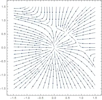

Look at a phase portrait to verify the results
