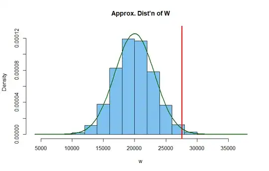

Suppose $X \sim \mathsf{Norm}(\mu_x=100,\sigma_x=15)$ and $Y \sim \mathsf{Norm}(\mu_y = 200,\sigma_y=10).$ Then a simple simulation will give you a pretty good idea of the distribution of $W = XY.$ You can easily get approximations of $\mu_w = E(W),\,\sigma_w = SD(W),$ and even the 99th quantile $q$ of $W,$ which is $q$ such that $P(W \le q) = 0.99.$ Note that $X$ and $Y$ are independent in this simulation. (This simulation used R statistical software, which is freeware, but many math and stat software packages could do something similar.)
m = 10^6;  x=rnorm(m, 100, 15);  y=rnorm(m, 200, 10)
w = x*y;  mean(w);  sd(w);  quantile(w, .99)
## 19997.9    # aprx E(W)
## 3170.564   # aprx SD(W)
##      99%
## 27581.54   # aprx q with P(X < q) = .99
Below is a histogram of the simulated distribution. The vertical red line cuts 1% from its upper tail. The curve is the density curve of a normal distribution with a mean and SD suggested by the simulation.
This simulation suggests that the product $W$ may be approximately normal, but in general, the product isn't normal. Sometimes not even close. Never make an important bet on the basis on one simulation.
Based on this arbitrarily chosen simulation, maybe you are interested in pursuing the theory behind your question, maybe you will want to try more simulations (matching an actual applied problem of interest), or maybe this will be the end of your interest. Particularly if you want to pursue the theory, please edit your question to be more specific about your goals.
