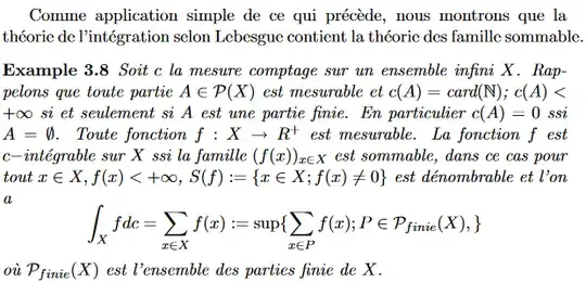

This is something I've been wondering myself long time ago. I've first encountered this topic while taking a Measure Theory course with a french professor (btw, one of the best courses I've ever had, absolutely brilliant)
I asked him for references but he didn't say anything useful (I'm not sure if he didn't want to tell me or if he didn't know either) Anyways, I've come to realize that this is something which is often taught in france. If you can read french, then you can easily find several documents on the subject, just look for "familles sommables"
You can look at the french Wikipedia entry
There is a useful Master thesis, and this one is great too. Here are some exercises with solutions
If you want an english reference, have a look at Choquet's Topology. Apparently it appears in Dieudonné's treatise too, but I don't know where.
Finally, this is one of the most important things you want to know about this
Bonne lecture!
