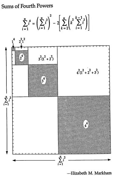

26
On this book: http://www.amazon.com/Proofs-without-Words-Exercises-Classroom/dp/0883857006
Is given the following solution:
Proofs Without Words
I guess that with a bit of calculation it is possible to get to the formula for $$\sum_{i=1}^ni^4$$
I know that we miss all the stuff about the fifth dimension... but in this way the proof is much easier to visualize...
