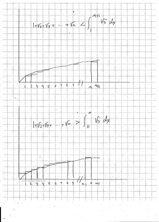

picture......................................
$$ \frac{2}{3} n \sqrt n < \mbox{SUM} < \frac{2}{3} \left( \; (n+1) \sqrt {n+1} \; - \; 1 \right) \; < \; \frac{2}{3} \left( \; (n+1) ( 1 +\sqrt n) \; - \; 1 \right) = \frac{2}{3} \left( \; n \sqrt n + n + \sqrt n \right) $$ $$ \frac{2}{3} n \sqrt n < \mbox{SUM} < \frac{2}{3} \left( \; n \sqrt n + n + \sqrt n \right) $$
For anyone worried about the little estimate above, $$ n + 1 < n + 2 \sqrt n + 1, $$ $$ \sqrt {n+1} \; \; < \; \; 1 + \sqrt n. $$
Will Jagy
  • 146,052
