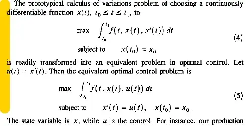

The book defines the variational problem and the corresponding optimal control problem:

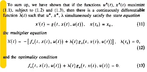

Then it states the optimality conditions in terms of the Lagrangian:

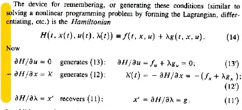

And finally, it states that conditions on the Hamiltonian are effectively mnemonics, to easier remember the conditions on the Lagrangian:
Is my interpretation correct that the Hamiltonian is merely a mnemonic for the Lagrangian? This seems absurd to me.

    I am not too familiar with optimal control, but, in mathematical physics, the Hamiltonian formalism is preferred due to its theoretical properties. In particular, the minimization of the action for a system with $n$ variables corresponds to solving $n$ second order differential equations. In contrast, the same problem in Hamiltonian mechanics corresponds to solving $2n$ coupled first order differential equations. The first order equations are more tractable theoretically. – Kayle of the Creeks Sep 01 '17 at 09:26
  • Another advantage of Hamiltonian is that in a closed system, the value of Hamiltonian itself is constant, while Lagrangian is not. – syockit Jan 31 '21 at 03:55
