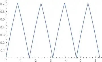

Differentiable is hopeless. The minimum and absolute value are not differentiable, so this is a lot to expect. Example: $$ \begin{pmatrix} \sin t & 0 \\ 0 & \cos t \end{pmatrix} \text{.} $$
We plot the minimum eigenvalue for this matrix
Minimum Eigenvalue

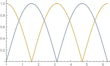

as well as the absolute values of the eigenvalues (tracking which is which by color).
Mathematica graphics
