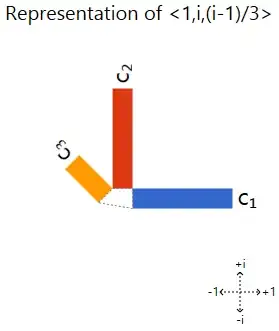

The pictures will use what I called a "phased bar chart", which shows complex values as bars that have been rotated. Each bar corresponds to a vector component, with length showing magnitude and direction showing phase. An example:
Example phased bar chart
The important property we care about is that scaling a vector corresponds to the chart scaling or rotating. Other transformations cause it to distort, so we can use it to recognize eigenvectors based on the lack of distortions. (I go into more depth in this blog post.)

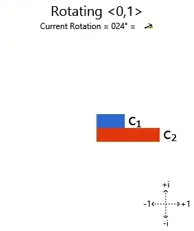

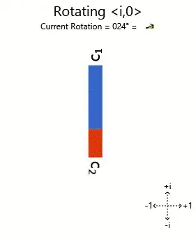

So here's what it looks like when we rotate <0, 1> and <i, 0>:
Rotating 0, 1 Rotating i, 0
Those diagram are not just scaling/rotating. So <0, 1> and <i, 0> are not eigenvectors.

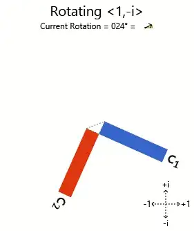

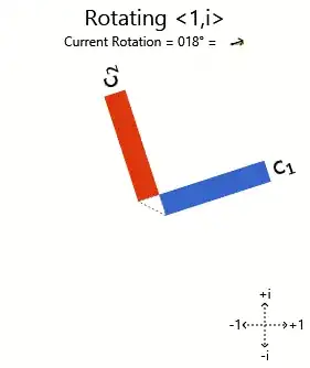

Trying <1, i> and <1, -i>:
Rotating 1, i Rotation 1, -i
There you have it. The phased bar charts of the rotated eigenvectors are being rotated (corresponding to the components being phased) as the vector is turned. Other vectors get distorting charts when you turn them, so they aren't eigenvectors.
