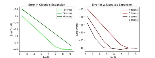

Since Claude's answer above has an expansion that disagrees with the one I found on Wikipedia, I thought I should numerically test which is correct. It turns out that Wikipedia's expansion is the correct one, as the following plots demonstrate:
I can provide the code that produced these plots if someone wants to double check.

You could use the fact that $$S_k=\sum_{i=1}^k\frac{1}{i^2} =H_k^{(2)}$$ where appear the generalized harmonic numbers and, for large $k$ use the asymptotics $$S_k=\frac{\pi ^2}{6}-\frac{1}{k}+\frac{1}{2 k^2}-\frac{1}{6 k^3}+\frac{1}{2 k^4}-\frac{29}{30 k^5}+\frac{3}{2 k^6}+O\left(\frac{1}{k^7}\right)$$ For example, using $k=10$ (which is not large at all) the direct summation would give $\frac{1968329}{1270080}\approx 1.54977$ while the above expansion would lead to $\frac{\pi ^2}{6}-\frac{570749}{6000000}\approx 1.54981$.
Concerning the second one, we can write $$\sum_{i=k+1}^n\frac{1}{i^2}=\sum_{i=1}^n\frac{1}{i^2}-\sum_{i=1}^k\frac{1}{i^2}=S_n-S_k$$ and reuse the above expansion. For example, using $k=10$ and $n=20$, the direct summation would give $\frac{100571322842761}{2167695039654144}\approx 0.0463955$ while using twice the above expansion would lead to $\frac{17801029}{384000000}\approx 0.0463568$.
Edit
For sure, as felipeh did in his/her answer, it would be better to use Euler-Maclaurin Summation Formula (see here) (rather than the Taylor expansion I used); this write $$\sum_{i=1}^k\frac1{i^2}=\frac{\pi ^2}{6}-\frac1k+\frac1{2k^2}-\frac1{6k^3}+\frac1{30k^5}-\frac1{42k^7}+\frac1{30k^9}-\frac5{66k^{11}}$$ which, for the worked examples given above, would give almost exact values.
- 289,558
I ran some numerical tests to see which of our expansions is correct and it seems that Wikipedia's is more accurate. I just wanted to know if I should correct Wikipedia, didn't mean to put you on the spot. – felipeh Aug 30 '17 at 14:18
I shall restart the work tomorrow morning and I shall let you know. I do not see where I have done some mistake. In any manner, thanks for pointing out the problem. Cheers. – Claude Leibovici Aug 30 '17 at 14:21
