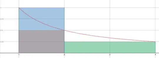

Let's prove that $\ln 2 < 1 < \ln 4$.
Consider the graph of $\dfrac1x$.
The rectangle $[1,2] \times [0,1]$ contains the area of the graph for $x \in [1,2]$. Therefore, $\ln 2 < 1$.
The rectangles $[1,2] \times [0,\dfrac12]$ and $[2,4] \times [0,\dfrac14]$ are contained in area of the graph for $x \in [2,4]$. Therefore, $\ln 4 > 1$.
