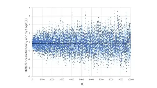

EDIT: These are two graphs to better illustrate the question. The first one is a plot of the difference between $S_K$ and $1/2 \, \sqrt{K}\,$ vs $K$, for the first $10^4$ values of $K$. The black line is the best fitting one and is set at a value of $\approx -0.32$.

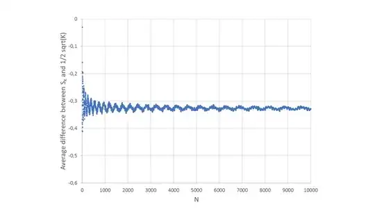

The second graph is a plot of the average value of $S_K - 1/2 \, \sqrt{K}\,$, calculated over the first $N$ positive integers, vs $N$. As expected according to the first graph, the average value of the difference converges towards $\approx -0.32$. enter image description here
