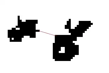

We have two digital blobs of arbitrary shape, i.e. two connected components on a digital image. They are described by a run-length-coded representation, i.e. a list of $(x, y, l)$ triples of integers.
I want to find the shortest Euclidean distance between them (from pixel center to pixel center) in an efficient way.
Emphasis is on speed, and the obvious brute-force approach (trying every pair of run endpoints) isn't acceptable. Good asymptotic behavior is not necessarily a concern, the solution must be truly fast.
The blobs are usually of moderate size (say $50$ runs) but can on occasion be larger (say $1000$).
There are two degrees of freedom:
  • short preprocessing of the blobs is allowed, as several distances to a given blob will be computed;
  • an approximate solution is allowed (say to a relative error of $20\%$).
How would you tackle this ?
