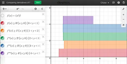

I have been considering the function $\Pi(x)=\Gamma(x+1)$. You can find a discussion about the very nasty $n$th derivative here. I did, however, run a graph of it through the web graphing calculator Desmos. Basically, each higher bar is a higher derivative of $\Pi(x)$, and it spans the positive interval on which $\Pi^{(n)}(x)\ge n!$
Once I got to $\Pi^{(4)}(x)$, it started crashing, which is why the purple bar is incomplete (if it were meant to stop around $x=5.3$, then there would be a bold vertical line).
To me, this small sample seems to suggest that $\Pi^{(n)}(a)\ge n!$ for $a$ at least greater than or equal to $2$, which would make the coefficients of $T[\Pi(x),a]$ all be greater than or equal to $1$, so $T[\Pi(x),a]$ would diverge.
