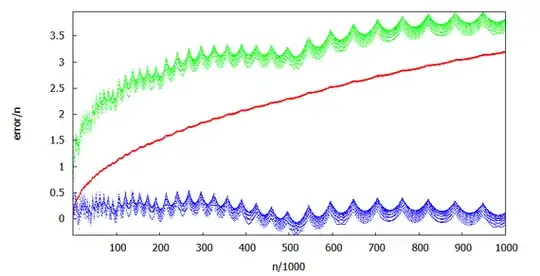

I have plotted their errors in a single picture:
Errors in different approximations
In above picture,
  • the red curve is $\frac{1}{10n}(a_n - a^{[0]}_n)$,
  • the green curve is $\frac{1}{n}(a_n - a^{[1]}_n)$,
  • the blue curve is $\frac{1}{n}(a_n - a^{[2]}_n)$,
There are two observations one can make:
  1. The red curve and green curve has approximately the same size. Since the red curve represent errors of original approximation scaled down by a factor of ten, approximation $a^{[1]}_n$ is about an order of magnitude better than $a^{[0]}_n$
  2. Unlike the red and green curves which drift away from $0$, the leading behavior of the blue curve is some cusp like oscillation, the amplitude doesn't seem to die down as $n$ increases and the period of seems to grow very slowly.
    What this means is if one want to go beyond approximation $a^{[2]}_n$, one need to include corrections other than powers of $n$. A classical asymptotic expansion purely in terms of powers of $n$ and $\log(n)$ won't work.
