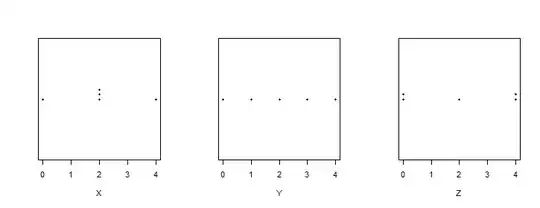

Given a sample $X_1, X_2, \dots, X_n,$ suppose we make a 'stripchart' (also called 'dotplot') of the data. Shown below are stripcharts of three samples of size $n=5:$ $$X = (0, 2, 2, 2, 4),\, Y = (0, 1, 2, 3, 4),\, Z = (0, 0, 2, 4, 4).$$
The sample mean $\bar X = \frac{1}{n}\sum_{i=1}^n X_i$ can be considered as the 'balance point' or 'center of gravity' of the stripchart of a sample $X_i$ (where all dots have the same weight). The sample mean $\bar X$ is also a good estimate of the mean $\mu_X$ of the population from which the sample is randomly chosen. In particular, $E(\bar X) = \mu_X.$ In the figure, $\bar X = \bar Y = \bar Z = 2.$
One way to measure the dispersion or variability of a sample is its range $R = \max(X_i) - \min(X_i).$ For our three small datasets $R_X = R_Y = R_Z = 4,$ so the sample range is not an effective measure of dispersion for distinguishing among our three datasets.
Yet, it seems intuitively clear that the $Z_i$s are the most disperse and the $X_i$s are the least disperse. As a physical model think of a vertical shaft or axis at 2, around which a stripchart is to be spun. The moments-of-inertia increase as we move from the $X_i$ to the $Y_i$ to the $Z_i.$ Roughly speaking, that is to say, the $Z_i$ make the best flywheel.
A measure of dispersion that closely parallels the definition of moment-of-inertia is the sample variance. It is roughly the average of the squared deviations about the mean: $S_X^2 = \frac{1}{n-1}\sum_{i=1}^n (X_i - \bar X)^2.$ For our three examples, $S_X^2 = 2.0,\, S_Y^2 = 2.5,\,$ and $S_Z^2 = 4.$ So the variances do increase appropriately as we move from the $X_i$ to the $Y_i$ to the $Z_i.$ [The positive square root $S_X$ of the sample variance $S_X^2$ is called the 'sample standard deviation', which helps to explain the notation.]
