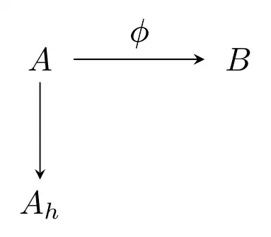

I have also been looking at the notion of base change where I hit a similar problem. Say the morphism $\phi: A \longrightarrow B$ makes $B$ into a finite-type $A$-algebra. We would like to claim that finite-type morphisms of schemes are preserved under base change. That is, we would like to be able to say that via base change, the morphism $$ A_{h} \longrightarrow B_{\phi(h)} $$ makes $B_{\phi(h)}$ into a finite-type $A_{h}$-algebra. I can do this the hands-on way by showing how finitely many generators of $B$ over $A$ map under localization, but I wanted to try to see this more abstractly. I wanted to see the localization $B_{\phi(h)}$ as the pushout of the diagram enter image description here
which would be the tensor product $A_{h} \otimes_{A} B$. Then I realized again that this would only be the case in the category of modules, which brought me back to my original confusion. Is it true that as rings, there holds $B_{\phi(h)} \simeq A_{h} \otimes_{A} B$? Or is it only true when we treat $A$ and $B$ as $\textit{modules}$ that $B_{h} \simeq A_{h} \otimes_{A} B$, in which case we could apply exactness results?

Your second concern is addressed by the following result. If $M$ is any $B$-module (so $M$ is also an $A$-module via $\varphi$) and $S$ is a multiplicative subset of $A$, then $T=\varphi(S)$ is a multiplicative subset of $B$, and there is a canonical isomorphism $S^{-1}M\simeq T^{-1}M$ given by $m/s\mapsto m/\varphi(s)$. When $M=B$, the isomorphism $S^{-1}B\simeq T^{-1}B$ is an isomorphism of $S^{-1}A$-algebras. But in particular it is still an isomorphism of $S^{-1}A$-modules. So again you can apply results about localizations of modules. Or, alternatively, as above, you could reason directly.
