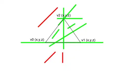

Math gurus,
I apologize because in a previous post I asked how to determine if a line passes through a triangle; and an answer was given. Then, while testing, I came across the scenario where a vertical line “segment” was below the base of the triangle and the answer to my previous question was giving false positives. This was my own fault because clearly there is a difference between a line and a line segment.
Below is a diagram of what I would like to accomplish. All the green line segments are considered to be passing "through" the triangle. The red line segments (obviously) do not.
The data I am using has x, y and z values, but for this test, we can assume the triangle and line segment will be coplanar.
The triangle I am using for testing is defined by the points:
vo = (2,2,1) v1 = (7,2,1), v2 = (5,6,1)
and each of my tests cases are using these points:
  1. Line segment outside – no intersection: p0 = (1,4,1) p1 = (3,7,1)
  2. Intersection at vertex: p0 = (4,6,1) p1 = (8,6,1)
  3. Intersection through 2 edges: p0 = (4,1,1) p1 = (5,7,1)
  4. Intersection contains edge: p0 = (1,2,1) p1 = (5,8,1)
  5. Intersection through 1 vertex and edge: p0 = (5,1,1) p1 = (5,8,1)
Is there some specific formula that will provide a “true” / “false” indication as to whether a line segment passes over the triangle as described above?
I do NOT need to know the point of intersection in the case of a "true" result (but if it is part of determining the result, that would be a bonus).
Thank-you in advance for your help and patience.
bdcoder
  • 145
  • In all of your examples (green or red), both endpoints of the segment are outside the triangle. If one endpoint is inside the triangle but the other is outside, does the segment go "through" the triangle? What if both endpoints of the segment are inside the triangle? – David K Aug 04 '17 at 04:12
  • Yes - as shown in the diagram, if ANY part of a line segment crosses (touches?) the triangle or both end points are inside, it is considered "through" the triangle. – bdcoder Aug 04 '17 at 04:15
  • Thanks, I will try to clarify -- I have updated the diagram and some of the wording accordingly -- perhaps I should have used "pass over" the triangle? – bdcoder Aug 04 '17 at 04:23
  • The word "through" is OK, actually, because every green segment goes through at least some points of the interior or boundary of the triangle. The idea is not to make everything difficult for you (at least not more than it has to be by the nature of the question), but to think about all the possible cases carefully, because in order to get the right answers reliably you actually will have to cover all cases somehow. – David K Aug 04 '17 at 04:25
  • Yes, thanks again -- I have updated the diagram -- I think that covers all cases now. – bdcoder Aug 04 '17 at 04:30

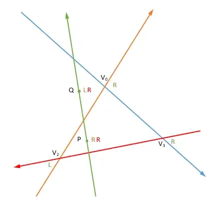

Two conditions must be met:
  • the line of support crosses the triangle. This can be checked by counting the triangle vertices on either side of the line, i.e. 3 LeftOf tests (PQV0, PQV1, PQV2).
  • the two endpoints may not both lie on the same side of the lines of support of the sides that are crossed. Takes 2 or 4 more LeftOf tests (among PV0V1, PV1V2, PV2V0, QV0V1, QV1V2, QV2V0; 3 on average).
In the example, two vertices are on the right of PQ and one on the left so that line crosses. It crosses the orange and red sides. Then P and Q aren't on the same side of the orange line.
  • Nice and succinct. I wonder how it compares in efficiency to the unrolled version in Nominal Animal’s answer. – amd Aug 07 '17 at 17:32
  • Mh, I am avoiding any division and there are opportunities for branchless evaluations. You perform 3 or 6 LeftOf tests (each $3+,2\times$, some values can be reused). –  Aug 07 '17 at 19:13
  • Ooops, I didn't notice that the frame was 3D. Then I would recommend to transform to 2D coordinates and take this opportunity to make some coordinates simple. –  Aug 07 '17 at 19:34
  • If the points are coplanar (or close to it numerically), I believe that one can get away with doing the “left-of” tests directly with the 3D coordinates. However, projecting to 2D first, especially if you can just drop a coordinate to do so, is likely to be faster overall. – amd Aug 07 '17 at 19:59
  • If P and Q are both inside the triangle, the question counts that as passing through, but they lie on the same side of all triangles. So the second part of this test looks wrong. – user2554330 Sep 25 '24 at 18:03
  • Sorry, "They both are on the same side of all three lines of support". – user2554330 Sep 25 '24 at 18:12
