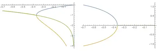

The Lambert W-function, i.e. the multivalued inverse of $z=we^w$, has countably many complex-valued branches $W_k(z)$. The relations between the branches are a bit involved and are summarized here. We will consider the behavior of the $k=0,-1$ branches for $x<0$. Using Mathematica, we obtain the following plots of $W_k(x)$ along the negative real axis:
Setting aside the green line for the moment, the two plots give the real and imaginary parts respectively of $W_0(x)$ (blue) and $W_{-1}(x)$ (orange). From this, we see that both branches are real for $x\in (-1/e,0)$. (The $k=0$ branch is additionally real for positive real $x$; no other branches obtain real values along the real line.) This is not surprising, as these branches correspond to the two real-valued inverses of $z=we^w$ along the real line.
What's perhaps surprising, though, is that (according to this plot) $\overline{W_{-1}(x)}=W_{0}(x)$ for all $x\in (-\infty,-1/e)$. (A derivation of this fact may be found in the Q&A linked in the comments below.) From this, we conclude that the average of these two branches, $\frac{1}{2}(W_0(x)+W{-1}(x))$, is real for all negative real $x$. This is the green line plotted above, and from the first plot we further ascertain that $\frac12 (W_0+W_{-1})$ is smooth across the point $x=-1/e$. (Further plotting in Mathematica suggests that $\frac12 (W_0+W_{-1})$ is analytic for all $x\neq 0$ such that $-\pi < \text{arg }x \leq \pi$.)
