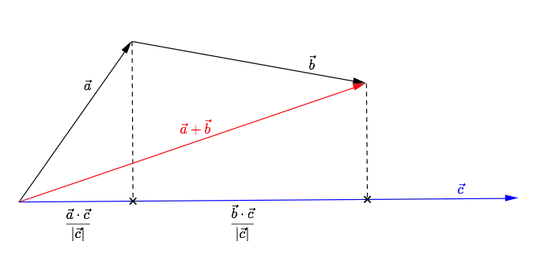

First of all you can prove from the geometrical definition that distributive property holds for scalar product: $(\vec a+\vec b)\cdot\vec c=\vec a\cdot\vec c+\vec b\cdot\vec c$ (see diagram below for a sketch of the proof).
Then, you just have to decompose two vectors along an orthonormal coordinate system: $\vec a= a_x\vec i+a_y\vec j+a_z\vec k$,$\quad$ $\vec b= b_x\vec i+b_y\vec j+b_z\vec k$, and apply twice the distributive property, taking into account that $\vec i\cdot\vec i=\vec j\cdot\vec j=\vec k\cdot\vec k=1$ and $\vec i\cdot\vec j=\vec j\cdot\vec k=\vec k\cdot\vec i=0$: $$ \vec a\cdot\vec b= (a_x\vec i+a_y\vec j+a_z\vec k)\cdot(b_x\vec i+b_y\vec j+b_z\vec k)= a_xb_x+a_yb_y+a_zb_z. $$
