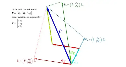

This youtube video by Eugene Khutoryansky makes the distinction clear between the covariant coordinates of a vector (dot product of the vector with each of the basis vectors or vector projection), and the contravariant coordinates (parallelogram law):
Is there a way you could explain to a lay person that this somehow underpins the following fact:
Covariant vectors are representable as row vectors. Contravariant vectors are representable as column vectors.
I would like to know, for example, if the idea carries beyond being able to calculate the length of a vector in non-Cartesian coordinates as the dot product of its covariant and contr$avariant expressions:
$$ \lVert V\rVert ^2=\begin{bmatrix} V_X & V_Y & V_Z\end{bmatrix}\cdot \begin{bmatrix} V^X \\ V^Y\\ V^Z\end{bmatrix}.$$

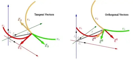

In a curvilinear system presumably the contravariant basis vectors would be tangential, whereas the covariant basis vectors would be orthogonal to the coordinates:

You can represent "contravariant vectors" as rows and "covariant vectors" as columns all right if you want.
It's just a convention. The dual space of the space of column vectors can be naturally identified with the space of row vectors, because matrix multiplication can then correspond to the "pairing" between a "covariant vector" and a "contravariant vector".
Remember that "covariant vectors" are defined as scalar-valued linear maps on the space of "contravariant vectors", so if $\omega$ is a covariant vector and $v$ is a contravariant vector, then $\omega(v)$ is a real number that depends linearly on both $v$ and $\omega$. If you make $v$ correspond to a column vector, and make $\omega$ correspond to a row vector then $$ \omega(v)=\omega v=(\omega_1,...,\omega_n)\left(\begin{matrix}v^1 \\ \vdots \\ v^n\end{matrix}\right)=\omega_1v^1+...+\omega_nv^n. $$
If $\omega$ was the column instead, then the above matrix multiplication would look as $\omega(v)=v\omega$, which would not look as aesthetically pleasing, as we are used to displaying the argument of a function to the right of the function, and in this case $v$ is the argument.
  • Thank you. This is very clear, and helpful. It would definitely clarify all the issues in the OP if you could touch on the geometry as sketched in the plot - I kind of see... at a very intuitive level that since the contravariant expression uses basis vectors tangent to the surface, while the covariant expression uses orthogonal projections, there ought to be a dot product lurking somewhere so as to keep the length of the vector independent of the coordinate system, or something along those lines... – Antoni Parellada Jul 29 '17 at 17:00
