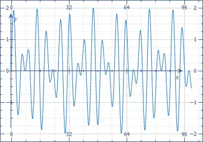

No, the sequence $s_n=\sin n$ is non converging and aperiodic, by the irrationality of $\pi$. The values will be non-repeating. Even if the values are discrete, the sequence may be non-repeating. Take $\lfloor\sin n\rfloor+1$:
$1 , 1 , 1 , 1 , 0 , 0 , 0 , 1 , 1 , 1 , 0 , 0 , 0 , 1 , 1 , 1 , 0 , 0 , 0 , 1 , 1 , 1 , 0 , 0 , 0 , 0 , 1 , 1 , 1 , 0 , 0 , 0 , 1 , 1 , 1 , 0 , 0 , 0 , 1 , 1 , 1 , 0 , 0 , 0 , 1 , 1 , 1 , 1 , 0 , 0 , 0 , 1 , 1 , 1 , 0 , 0 , 0 , 1 , 1 , 1 , 0 , 0 , 0 , 1 , 1 , 1 , 0 , 0 , 0 , 0 , 1 , 1 , 1 , 0 , 0 , 0 , 1 , 1 , 1 , 0 , 0 , 0 , 1 , 1 , 1 , 0 , 0 , 0 , 1 , 1 , 1 , 1 , 0 , 0 , 0 , 1 , 1 , 1 , 0 , 0 ,\cdots$
For an aperiodic, bounded function of a real variable, you can take $\sin x+\sin\sqrt2x$ (by irrationality of $\sqrt2$). Anyway, as it is continuous, it will "cycle" inside $(-2,2)$ and come back infinitely many times to all values.
