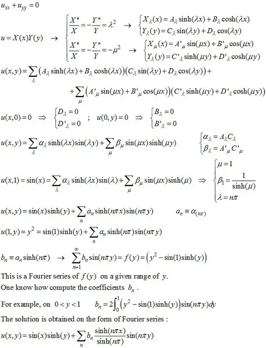

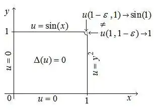

The boundary conditions at point $(1,1)$ introduce a singularity $$\begin{cases} u(x,1)=\sin(x) \quad\to\quad u(1,1)=\sin(1)\\ u(1,y)=y^2 \quad\to\quad u(1,1)=1 \end{cases}$$
This can be overcome with the solution in term of Fourier series:
