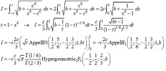

The result (below) as expected includes $ \frac{\Gamma(1/6)\Gamma(1/2)}{\Gamma(2/3)} = \sqrt{\pi}\frac{\Gamma(1/6)}{\Gamma(2/3)}$ and an hypergeometric function.
See Eq.(9) in : http://mathworld.wolfram.com/AppellHypergeometricFunction.html
For some particular values of $b$, the hypergeometric function reduces to functions of lower level.

  • Thank you @JJacquelin.. I tried to evaluate this in Mathematica using your steps.
    $$\frac{1}{3} c \int_0^1 \frac{\sqrt{b t-1}}{(1-t)^{5/6} \sqrt{t}} , dt$$
    But got a different answer(Given Below). Can you please explain why these are different. I also eager to know how to get an answer even without a gamma function.
    $$\frac{\sqrt{\pi } \sqrt[6]{1-b} \sqrt{b-1} c \Gamma \left(\frac{1}{6}\right) , Hypergeometric2F1\left(\frac{1}{6},\frac{7}{6};\frac{2}{3};b\right)}{3 \Gamma \left(\frac{2}{3}\right)}$$

    The two answers are not different, they are equal. Hypergeometric2F1$(-1/2,1/2,2/3,x)=$ $(1-x)^{1/6}\sqrt{1-x}$Hypergeometric2F1$(1/6,7/6,2/3,x)$. Do not expect simpler answer if you don't specify the value of $b$. – JJacquelin Jul 20 '17 at 13:25
  • They are a lot of relationships between Hypergeometric functions : http://functions.wolfram.com/HypergeometricFunctions/Hypergeometric2F1/17/02/07/ So, the same formula can be written on a lot of apparently different forms, but equal in fact. – JJacquelin Jul 20 '17 at 13:38
