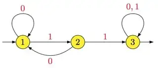

For your example, $u = 11$, the minimal automaton of $L(11)$ is
The minimal automaton of $L(11)$

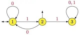

and the minimal automaton of its complement is
The minimal automaton of its complement
It is now easy to get a regular expression for the language accepted by this automaton: $(0 + 10)^*(\varepsilon + 1)$.
