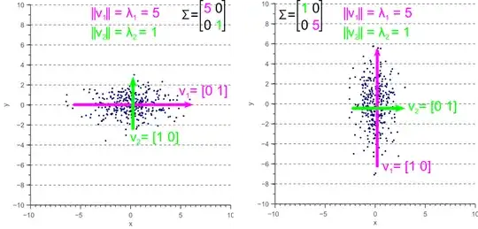

If the covariances are zero, then the eigenvalues are equal to the variances: enter image description here

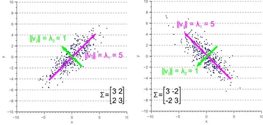

If the covariance matrix not diagonal, the eigenvalues represent the variance along the principal components, whereas the covariance matrix still operates along the axes: enter image description here
An in-depth discussion (and the source of the above images) of how the covariance matrix can be interpreted from a geometrical point of view can be found here: http://www.visiondummy.com/2014/04/geometric-interpretation-covariance-matrix/
