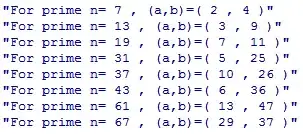

Image 1
These are some examples.
$2^2 + 2 \cdot 4 + 4^2 = 4( 1^2 + 1 \cdot 2 + 2^2) = 4 \cdot 7$
$3^2 + 3 \cdot 9 + 9^2 = 9( 1^2 + 1 \cdot 3 + 3^2) = 9 \cdot 13$
$7^2 + 7 \cdot 11 + 11^2 = 13( 2^2 + 2 \cdot 3 + 3^2) = 13 \cdot 19$
$5^2 + 5 \cdot 25 + 25^2 = 25( 1^2 + 1 \cdot 5 + 5^2) = 25 \cdot 31$
$10^2 + 10 \cdot 26 + 26^2 = 28( 3^2 + 3 \cdot 4 + 4^2) = 28 \cdot 37$
$6^2 + 6 \cdot 36 + 36^2 = 36( 1^2 + 1 \cdot 6 + 6^2) = 36 \cdot 43$
$13^2 + 13 \cdot 47 + 47^2 = 49( 4^2 + 4 \cdot 5 + 5^2) = 49 \cdot 61$
$29^2 + 29 \cdot 37 + 37^2 = 49( 2^2 + 2 \cdot 7 + 7^2) = 49 \cdot 67$
