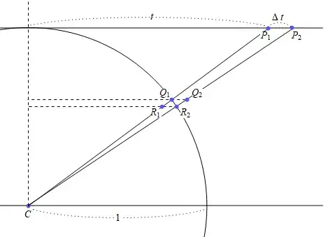

Here is a solution using trigonometry. Consider the following situation:
$\hspace{5em}$enter image description here
Since triangles $\triangle CP_1P_2$, $\triangle CQ_1Q_2$ and $\triangle CR_1R_2$ are congruent with ratio
$$1 \ : \ \frac{1}{\sqrt{1+t^2}} \ : \ \frac{1}{\sqrt{1+(t+\Delta t)^2}},$$
it follows that the area of the wedge $CQ_1R_2$, which equals $\frac{1}{2}\angle Q_1 C R_2$, is bounded between
$$ \frac{\Delta t}{2(1+(t+\Delta t)^2)} = \mathrm{Area}(\triangle CR_1R_2) \leq \frac{1}{2}\angle Q_1 C R_2 \leq \mathrm{Area}(\triangle CQ_1Q_2) = \frac{\Delta t}{2(1+t^2)}. $$
Hence for any $\theta \in (0,\frac{\pi}{2})$ and for any partition $\Pi = \{0 = t_0 < t_1 < \cdots < t_n = \tan\theta \}$ we have
$$ \sum_{i=1}^{n} \frac{\Delta t_i}{1+t_i^2} \leq \theta \leq \sum_{i=1}^{n} \frac{\Delta t_i}{1 + t_{i-1}^2}, \qquad (\Delta t_i = t_i - t_{i-1}). $$
Taking the limit $\|\Pi\|\to 0$, the squeezing lemma tells
$$ \int_{0}^{\tan\theta} \frac{dt}{1+t^2} = \theta. $$
Then taking $\theta \uparrow \frac{\pi}{2}$ proves the desired identity through symmetry.
