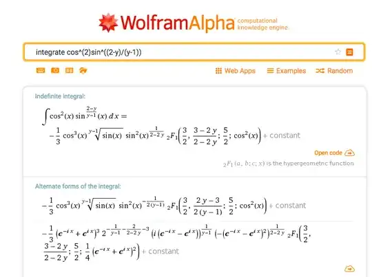

By the way, I typed the original integral in Wolfram Alpha and the answer it gave included some crazy function called the hypergeometric function.

  • Mathematica says this here $$-\frac{1}{3} \cos ^3(x) \sin ^{\frac{2 \alpha -3}{\alpha -1}}(x) \sin ^2(x)^{\frac{3-2 \alpha }{2 (\alpha -1)}} , _2F_1\left(\frac{3}{2},\frac{1}{2 (\alpha -1)};\frac{5}{2};\cos ^2(x)\right)$$ i think it is the same – Dr. Sonnhard Graubner Jul 01 '17 at 12:19
  • @Dr.SonnhardGraubner Yeah I think so too. Do you know how it obtained this expression though? – Joe Taylor Jul 01 '17 at 12:21
  • @JoeTaylor Wolfram uses the Risch algorithm to compute integrals, which works well, but sometimes spits out unreadable special functions. Is there any particular reason you believe this integral has a nice closed form? Where does it come from? – Dando18 Jul 01 '17 at 12:24
  • see here you can find some ther Terms https://www.wolframalpha.com/input/?i=integrate+cos(x)%5E2*sin(x)%5E((2-alpha)%2F(1-alpha)) – Dr. Sonnhard Graubner Jul 01 '17 at 12:29
  • @Dando18 To be honest I don't know if this integral has a "nice" solution. I'm just solving it for practice and want to see if the integral is graph-able or not. – Joe Taylor Jul 01 '17 at 12:55
    @JoeTaylor the Maxima Risch implementation, which is designed to avoid special functions, could not find a closed form. And you've seen what Mathematica outputs, so I'd be surprised if there is a "nice" closed form. If you wish to plot the integral, mess around with the 'b' slider here. – Dando18 Jul 01 '17 at 13:00
