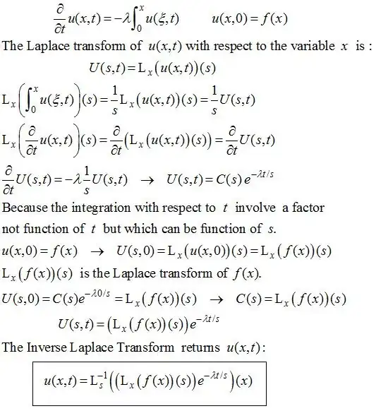

The solution detailed below is :
With $\quad F(s)=$ Laplace transform of $f(x)$.
$$\Phi(s,t)=e^{-\frac{\lambda \:t}{s}}F(s)$$ $$\boxed{u(x,t)= \text{ Inverse Laplace Transform of } \Phi(s,t)}$$
The result cannot be expressed more explicitly until the function $f(x)$ be explicitly given.
