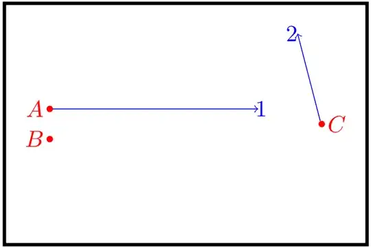

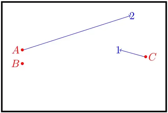

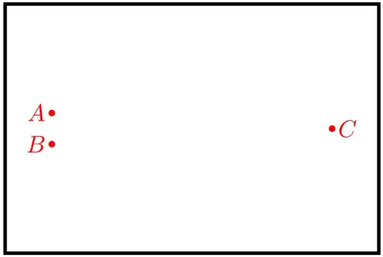

Background: I work for an Ambulance service. We are one of the largest ambulance services in the world. We have a dispatch system that will always send the closest ambulance to any emergency call. There is a belief that this results in the fastest response time as an average across the system.
Example: Suppose we have the following simplified scenario. We have 3 ambulances available (labelled A, B and C). At any given point in time, there is an random chance of an emergency call originating equally anywhere inside this box: enter image description here
If an emergency job appears (labelled 1), we will send the closest ambulance (in this case Ambulance C) enter image description here
You will notice that Ambulances A and B are very close together on the left side of the box (lets pretend they are just leaving a hospital after dropping off their patients). There is now a large gap on the right. Suppose a small amount of time passes, and another emergency call drops in (labelled 2).
Ambulance C is no longer available, so you must use Ambulance A or B. They have a significantly longer distance to travel to reach incident 2. In this case we have sent Ambulance A to the job.
Hypothesis: If you always send the closest ambulance to an emergency call, you will have the quickest response time to that specific call, but the overall average response time of the ambulance service is not optimised.
Using that hypothesis - it would seem to be better to send Ambulance A or B to the original incident 1. This would mean the the next incident to happen, there will be "on average" a significantly shorter distance for the next ambulance to travel. enter image description here
Question: How can I "prove" this? Is there a mathematical theory or formula? This is obviously a simplifed scenario, there are some other issues - but I just need to prove the fundamental issue that the "closest ambulance being sent to the next incident" actually results in a non-optimal response time across the system as a whole.

If you just want an explicit example, make your second incident happen exactly where C is stationed. Then in the scenario where
A picks up incident 2, C picks up incident 1
the total distance traveled is "distance between 1 and C" plus "distance between A and C" (since 2 is where C is stationed).
In the scenario where
A picks up incident 1, C picks up incident 2
the total distance traveled is "distance between A and 1" plus "distance between C and 2" (which is zero).
So we draw a picture with A, C, and 1 on it. The total distance traveled in the first scenario is two legs of the triangle formed by the three points. The total distance traveled in the second scenario is only one leg of the triangle. By the triangle inequality, the sum of lengths of two legs of one triangle must be bigger than the length of the third. This shows that the total distance traveled in scenario one, which is the "closest responder" scenario", can be non-optimal.

Scheduling algorithms have only access to information about the past, and are making guesses about what will optimize the unknown future. You have no clue when or where the next emergency will occur. By not sending the closest ambulance to a current emergency, you're risking somebody for a potential gain, which seems unethical. What if you send an ambulance from 10 miles away instead of from 2 miles away, and someone dies? And after that incident, there is no emergency for another 45 minutes?
The problem of keeping the ambulances geographically distributed can be solved without doing away with the closest ambulance policy.
If an ambulance is dispatched somewhere, what you can do is instruct other ambulances to move around in order to keep the ambulances evenly distributed.
Kaz
  • 7,007
  • Thanks Kaz. I've added a FAQ which might clear some of it up. Note - I would suspect that the most "correct" answer would factor in a weighted response - so the scenario you describe would not occur, or would be factored in. I was more thinking about instances where the difference is only 1-2 miles, not 10. In the case of "10 miles" - the weight formula would mean that the closest ambulance is still sent. – Laurence Nov 07 '12 at 23:13
I would approach this by making clear assumptions to you model first.
if you say that
1) all points in the square are equiprobable for an incident
2) all incidents must be responded to by immediately sending an ambulance
3) the cost (time) can be measured as the simple distance between two points
=>you would always try to to have the ambulances distributed across the area (here square) as uniformly as possible.
=> you can always send the nearest ambulance immediately
=> directly after, you send the remaining ambulances to the new points for optimal coverage
=> if two ambulances are equidistant from an incident, you send the one which makes the other ambulances travel as little as possible to reach the new coverage points.
I am sure that this can be proven, however I am not sure if these assumptions are acceptable for you...
Cheers Fab
I think first you need to prove that better assignments are possible with hindsight. Get a log with, for each call, the time the ambulance was sent out, the positions of the ambulances and of the incident, the ambulance sent, and the time of arrival. If the availability of ambulances varies, also log the times that they are in service. If this information isn't available, make it available. Collect these logs for a year (the density of incidents and maximum traveling speed are likely to fluctuate).
Now you can make a model of travel times between any two points in the area on any time of the day.
Based on this model, determine, per day in the log, all alternative assignments of ambulances to incidents and for each assignment compute the sum of the expected travel time from assigned ambulances to incidents. Plot the results. Show how much of a difference it makes. Translate into numbers of lives lost or similar. Do circumstances matter? (Is the difference lower or higher when the density of incidents is higher?)
Once you've done this, you've established that a different assignment policy may exist that will improve the average response time in the long run. The next step is to propose such an algorithm and to compare the assignments it produces against the actual assignments in the log. One idea is to estimate the probability of an incident occurring per area and per time of day, and somehow use this in deciding which ambulance to send.

Edge cases: The time it takes for ambulances A or B to arrive at incident 2 has to be less than it takes for ambulance C to handle incidents 1 and 2 one after another, otherwise it's useless to think about dispatching them.
Now about strategies. If we construct a scenario where the two incidents happen within few minutes after each other, and it is impossible to reroute an already dispatched ambulance because the second emergency would be more life threatening, this ambulance will take way longer to handle it's incident than it takes the second ambulance to arrive, and the positions for all the ambulances are fixed, and no ambulance should be sent elsewhere because of the first incident happening, then there really is nothing left to change to improve the situation.
Having the incident handling set in stone allows you to calculate the likeliness of such unfortunate situation to occur based on the factors I described above: a) How likely is it that two incidents occur shortly after another? b) How likely is it that the second incident occurs in a place that is located nearer to the now dispatched ambulance? Think about the emergency probability distribution on the map. c) How likely is it that the second incident is more urgent than the first, and the first is so unhasty that the proper order would be to handle the second first if both emergencies would have been reported at the same time, thus allowing to choose the order.
If you think about it, it might be easy to construct a scenario where dispatching ambulance A to the first emergency makes sense: If ambulance C is located in an area with high emergency probability, thus high probability of two emergencies to occur, and both being equally urgent, and ambulance A being close enough that it can reach emergency 1 in time. But in such a scenario it might be a better option to permanently relocate ambulance A next to ambulance C to improve the situation, because the probability distribution for an emergency would make it somehow predictable that such a situation will occur.
I would conclude that it is in general the best strategy to send the nearest available ambulance to any emergency that occurs. Deviating from such strategy can only be justified if the initial location of ambulances is suboptimal compared to the probability of an emergency.

It seems your (mathematical) intuition is wrong, at least under the constraints you specified. Let's firm them up as follows:
  1. The goal is to optimize the average time it takes to reach an incident.
  2. The starting locations of the ambulances are fixed. The question is what order to dispatch them in.
  3. Once an ambulance is dispatched, it is permanently unavailable: It cannot serve other incidents during the same trip, or return to service before the end of the calculation.
Note that after the second ambulance is dispatched, there is only one ambulance left, and it no longer matters where, timewise: There's a 50% chance that the third incident will be in the opposite side of the map. So, the question is: Starting with the 2 : 1 configuration you present, which dispatch strategy will result in the quickest response, on average, over the first two incidents?
The result can be generalized to larger sizes, but the two-incident case is instructive. The answer will surprise you: The nearest-ambulance strategy is better!
A, B ----------------------'---------------------- C
Let's draw a line from A/B to C, and label it as the interval [0, 1]. An incident is a uniformly distributed random variable t in this interval. We can equate response time to distance: If there are ambulances on both sides, the response time to an incident at point t is min(t, 1-t). If ambulance A must be dispatched, the response time is simply t.
The expected value of t, E(t), is 0.5. Obviously t is closer to the left if t < 0.5. It's easiest to consider scenarios by grouping incidents into two random events: Let's call an event L if t is in the left half of the range (t < 0.5), and R if it is in the right half. Then R and L occur with probability 0.5 each.
There can be four two-incident patterns, occurring with equal probability (0.25): LL, LR, RL, RR. If you could always dispatch from the closest side, the expected travel is 0.25 per incident. You incur a cost when you have to dispatch from the wrong side of the map. The expected length of a "long" trip is 0.75.
So, the payoff matrix is:
incidents   dispatch closest   dispatch A
 L L            A, B             A, B
 L R            A, C             A, C
 R L            C, A             A*, B
 R R            C, A*            A*, C
The right column is your proposed strategy: dispatch A first, then whichever is closest. A star means that the ambulance had to make a long trip (from the wrong side of the map) to get there. Note that there are more stars (penalties) on the right column.
The fourth row in the table is the one you're worried about: What if there's another incident on the right side of the map, after you've dispatched C? The answer is, don't worry! The bottom row has exactly the same cost under the two strategies: When you dispatched A to the first incident, you already incurred the cost you were trying to avoid in the second incident.
But the third case is one you didn't factor in: What if you send A on a long trip, and then C is not needed after all? In this case, dispatch-A will take longer than the dispatch-closest algorithm.
Since dispatch-A is not better under any scenario, dispatch-closest is superior on average.
Informal summary: If C is closer but you dispatch A, as you propose, you incur a penalty equal to the benefit you will reap if the next incident is nearer to C. So you would break even at best. But the next incident might be closer to A, and you'll never get to collect on your investment. Conclusion: Dispatching the closest ambulance is the better strategy. You can only do better by improving the distribution of ambulances before the second call comes in, as various others suggested. Once the phone rings, sending the closest car is in fact globally optimal.

Considering that there is no real way to know where or when the next call comes in then there is no real way to pick an ambulance other than the current closest one.
However, you can alter the situation a bit in order to optimize response times.
To do this rebalance the equation. What I mean by this is that once ambulance C has responded to the first call, then you should reposition ambulance A to provide equal coverage across the given area.
This means that ambulances must be constantly manned and they will be in motion quite a bit moving from one part of the area to another. This will result in increased costs (for example gas). However, if you pay attention and properly place your ambulances while constantly rebalancing the target coverage you will end up with reduced response times.
Do you have some legal obligations you must comply with? Some countries have laws that guarantee (to some degree of course) the citizens that ambulance arrives in some specified time frame after an incident has been reported. Which is (probably) actually more important than arriving as soon as possible, since there are some physiological processes that simply are time constrained and had help arrived later it would have just wasted resources.
In such a case you might want to take into account how big unserviceable area would be created by sending C to 1 in the sense of the time constraint and compare it with the same area created by sending A there (because A is either not located at exactly the same place as B or the probability of an incident there is much higher). You "just" need to find the least wrong metric that would take into account at least the most important factors.
Of course - as already mentioned - real-life data will help you a lot. It can even show, that the current distribution of stations is suboptimal with respect to the long-term statistical distribution of incidents.
