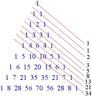

$6.$ Pascal triangle and Fibonacci numbers:
This image is quite self explainatory, the Fibonacci numbers are sum of shallow diagonals of Pascal triangle. We represent it mathematically as $F_n={\sum_{k=0}^{[\frac{n}{2}]}}$ ${n-k+1}\choose{k}$ where $[ \ ]$ is floor function.
