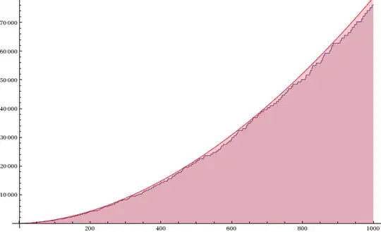

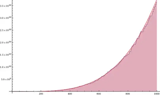

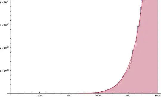

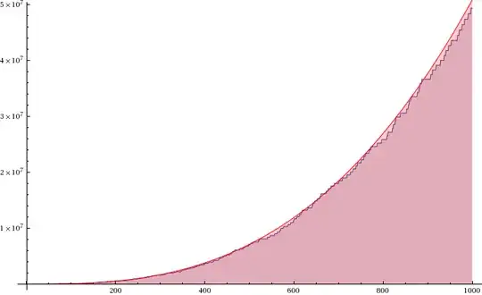

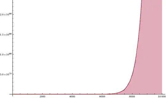

This is not an answer but a plot for $m=1,2,3,10,20$ because some peopel asked for that.
EDIT: This is somewhat an answer now, see below.
I entered the following code in Mathematica:
m = 1
maxx = 100
p1 = DiscretePlot[Sum[Prime[n]^m, {n, PrimePi[x]}], {x, maxx}];
p2 = DiscretePlot[LogIntegral[x], {x, maxx}, PlotStyle -> Red];
Show[{p1, p2}]
It seems alright for small $m$, as you can see below.
Okay, so in this paper we find that: $$\sum_{p\leq x\text{ prime}}f(p)\approx\int_2^x \frac{f(y)dy}{\ln y}$$
Substituting $f(p)=p^m$ gives, according to wolfram alpha: $$\sum_{p\leq x\text{ prime}}p^m\approx \text{Ei}((n+1)\ln x)= \text{Ei}(\ln x^{n+1})=\text{Li}(x^{n+1})$$
$m=1$ m=1 $m=2$ m=2 $m=3$ m=3 $m=10$ m=10 $m=20$, $maxx=10000$ m=20
