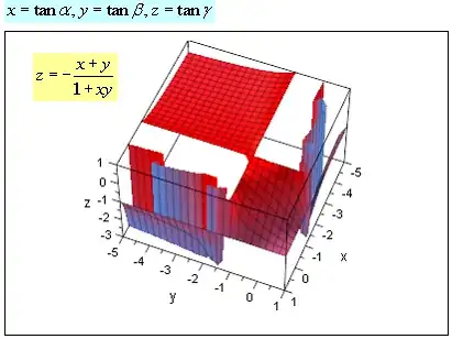

Equation (4) tells us that the solutions to (1) are reconducible to the roots of the symmetric polynomial $$ \bbox[lightyellow] { P(x,y,z) = x + y + z + xyz = x\left( {1 + yz} \right) + y + z } $$ which can be easily found by expressing one variable in terms of the other two, and which are rendered graphically by this plot.
Prod_3_Tan_1
Note the similarity of the solution to the above with the addition formula for $\tanh$ $$ \bbox[lightyellow] { x = - {{y + z} \over {1 + yz}}\quad \leftrightarrow \quad - \tanh \left( {c + d} \right) = - {{\tanh c + \tanh d} \over {1 + \tanh c\tanh d}} } $$ which would deserve to be further expanded.

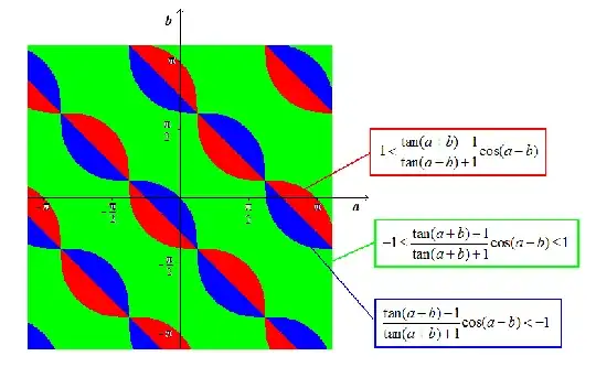

$$\tan(a+b)\tan(b+c)\tan(a+c)=1 \tag 1$$ $$\tan(b+c)\tan(a+c)=\frac{\cos(b-a)-\cos(b+a+2c)}{\cos(b-a)+\cos(b+a+2c)}$$ $$\tan(a+b)\frac{\cos(b-a)-\cos(b+a+2c)}{\cos(b-a)+\cos(b+a+2c)}=1$$ This can be solved for $\cos(b+a+2c)$ $$\cos(b+a+2c)=\frac{\tan(a+b)-1}{\tan(a+b)+1}\cos(a-b)$$ $$c=\frac{1}{2}\left(-a-b+\cos^{-1}\left(\frac{\tan(a+b)-1}{\tan(a+b)+1}\cos(a-b) \right) \right) \tag 2$$ If we chose arbitrary values of $a$ and $b$, Eq.(2) gives $c$ so that Eq.(1) is satisfied. But $c$ can be complex. To obtain $c$ real, the condition is : $$-1\leq \frac{\tan(a+b)-1}{\tan(a+b)+1}\cos(a-b) \leq 1$$
On the graph, the areas allowed for $(a,b)$ to achieve $c$ real are drawn in green. The whole is periodic as expected.
NUMERIAL EXAMPLE :
For example, $a=0.2$ and $b=0.75$
$\frac{\tan(a+b)-1}{\tan(a+b)+1}\cos(a-b)\simeq 0.141608$
$c=\frac{1}{2}\left(-a-b+\cos^{-1}\left(\frac{\tan(a+b)-1}{\tan(a+b)+1}\cos(a-b) \right) \right)\simeq 0.239355$
$\tan(a+b)\tan(b+c)\tan(a+c)\simeq 1.000000$
$\cos^{-1}$ is multi-valuated. Other convenient values of $c$ are obtained, for example $c\simeq 1.952237$
Of course, a numerical example isn't a proof. The analytic proof is above. This shows that one can obtain an infinity of solutions with the above method.
