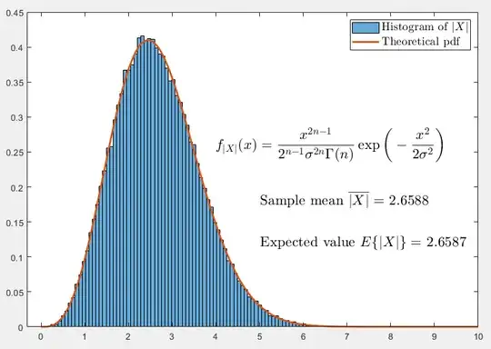

Here's a numerical simulation of the norm of $10^5$ different vectors following the conditions in the OP, with equal $\sigma$, and the theoretical pdf written above (I also tested different number of vector dimensions $n$ and variance $\sigma^2$). You can see it follows the distribution nicely. For the calculation of the mean, MATLAB does not have a built-in function to compute the binomial coefficient with non-integers, but I used the expression defined in terms of the Gamma function to get the expectation and test results. This is my updated code, that involves the calculation of the sample mean and the expectation (and see they're very close): Distribution of the norm of vector X, with computation of the mean

% simulation settings
nSim=1e5; %number of experiments
n=2; % dimension of complex vector
sigma2=2; % variance of all elements
% random realizations of vector X
X = (randn(n,nSim)+1i*randn(n,nSim))*sqrt(sigma2);
% compute the norm
normX=sqrt(sum(abs(X).^2,1));
% compute sample mean and theoretical expected value
mean_normX_sample = mean(normX)
mean_normX_theoretical = sqrt(2*sigma2)*gamma(n+1/2)/gamma(n)
% define pdf for plotting comparisons
x=0:0.01:10;
f=x.^(2*n-1)/(2^(n-1)*sigma2^n*gamma(n)).*exp(-x.^2/(2*sigma2));
% plot
figure(1)
histogram(normX,100,'normalization','pdf'); hold on
plot(x,f,'Linewidth',2); hold off
lgn=legend('Histogram of $|X|$','Theoretical pdf');
lgn.FontSize=13;
lgn.Interpreter='latex';
text(4,0.26,'$\displaystyle{f_{|X|}(x)={\frac  {x^{{2n-1}}}{2^{n-1}\sigma^{2n}\Gamma (n)}}\exp\bigg(-\frac{x^2}{2\sigma^2}\bigg)}$','interpreter','latex','FontSize',16);
text(5, 0.18, ['Sample mean $\overline{|X|}=$ ' num2str(mean_normX_sample)] ,'interpreter','latex','FontSize',16);
text(5, 0.12, ['Expected value $E\{|X|\}=$ ' num2str(mean_normX_theoretical)] ,'interpreter','latex','FontSize',16);
