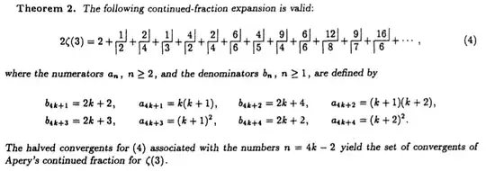

This is not an answer, just a comment from A few remarks on ζ(3) - Yu. V. Nesterenko
  • Many thanks. So ... if we could just modify that continued fraction to make the old theorem apply ... :) – Old John Nov 05 '12 at 15:42
