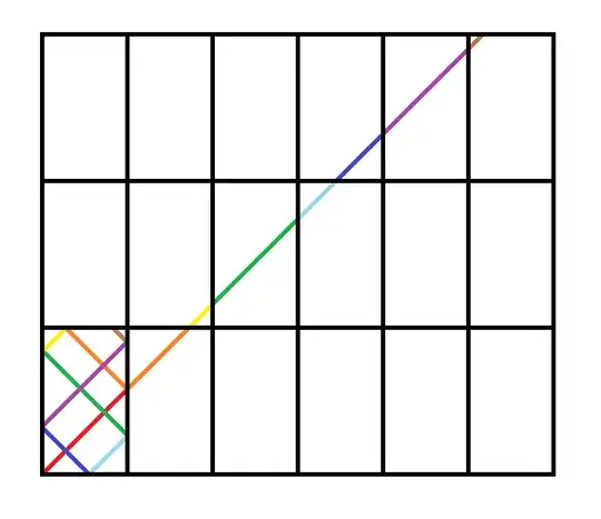

I have an idea how to model the problem. Look at the picture: when the ball bounces, it may be thought as entering a virtual pool placed next to the one it's coming from. Now, thinking of a coordinate system whose origin is in the bottom left corner, the tables corners have coordinates $(nx, my)$ with $n, m \in \mathbb N$, and you want them to be equal so that they can be touched by the ball travelling at $45°$. So $nx=my$ for some $m, n$, that is $n/m = y/x$. I think this is providing the solution: to ever reach another corner the sides of the table must be commensurable. And the number of bounces is $n+m-2$.enter image description here
