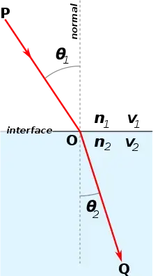

Snell's law from geometrical optics states that the ratio of the angles of incidence $\theta_1$ and of the angle of refraction $\theta_2$ as shown in figure1, is the same as the opposite ratio of the indices of refraction $n_1$ and $n_2$.
$$ \frac{\sin\theta_1}{\sin \theta_2} = \frac{n_2}{n_1} $$
figure 1
(figure originally from wikimedia)
Now let $P$ be a point in one medium (with refraction index $n_1$) and $Q$ a point in the other one as in the figure. My question is, is there is a nice geometrical construction (at best using only ruler and compass) to find the point $O$ in the figure such that Snell's law is satisfied. (Suppose you know the interface and $n_2/n_1$)?

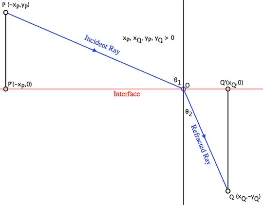

If you know the interface, then drop perpendiculars from $P$ and $Q$ to the interface. Let the points of intersection be $P'$ and $Q'$. Let $PP' = y_P$ and $QQ' = y_Q$.
Now consider the line segment $P'Q'=x$. You need to find a point $O$ inside $P'Q'$ such that $OP' + OQ' = x$.
Let $OP' = x_P$ and $OQ' = x_Q$. enter image description here
We now have two equations to solve for $\theta_1$ and $\theta_2$.
$x_P + x_Q = x$ i.e. $$y_P \tan(\theta_1) + y_Q \tan(\theta_2) = x$$
and
$$\frac{\sin(\theta_1)}{\sin(\theta_2)} = \frac{n_2}{n_1}$$.
So the problem is well-defined and hence solving for $\theta_1$ and $\theta_2$ gives $x_1$ and $x_2$.
I shall post the geometric construction later.

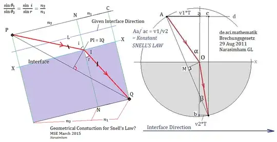

As queried in my comments options so far not replied by OP, I assume that points P and Q are given as fixed, and the interface direction is given,but it is not required to pass through any given point. Accordingly, given temporary interface direction straight line L can be parallelly displaced to pass through a point of incidence I, yet to be found out.
Label I is used instead of O to avoid imagining point of incidence as fixed at origin.
Draw parallel and perpendicular directions to L passing through P and Q so that they intersect at C.Divide PC in the ratio $ n_2 : n_1 $ in the usual way ( Draw $ n_2 , n_1 $ inches or centimeters from a corner and draw parallels for such proportionate division of line L into two segments). Draw line NN parallel to QC. Let the perpendicular bisector of PQ intersect NN at I, the point being sought.Draw line XX parallel to PC. Now XX is the interface straight line.Since $ PI= QI $,
Special Case when P and Q are given with respect a given fixed horizontal Interface (slope L = 0):
It is easier. Divide horizontal projection of PQ in the ratio $ n_2:n_1 $ to draw vertical line NN. The perpendicular bisector of PQ cuts NN at desired point I.
$$ \dfrac{\sin i}{\sin r}= \dfrac{\sin \theta_1}{\sin \theta_2} = \dfrac {PN/PI}{QN/QI} = \dfrac{PN}{QN} = \dfrac{n_2}{n_1} = \mu. $$
The interface cannot be a fixed line. I had earlier answered the question in German newsgroup de.sci.mathematik.
The one and only way for a ray of light to travel between two given fixed points is to have an interface curve shaped as one among curved confocal Cartesian Ovals. This is a direct geometric consequence of Fermat's Law.
In other words perpendiculars onto correctly positioned interface normal should be in ratio $ n_2/n_1. $

  • The distance $PX$, $QX$ of $P$ and $Q$ from the interface are given in advance and cannot be the result of the construction. – Christian Blatter Mar 05 '15 at 17:32
  • @Christian Blatter: The case of fixed L direction with zero slope is a special simple case shown. – Narasimham Mar 06 '15 at 10:09
  • Thanks for your link to the german math newsgroup. There seems to be an answer which proves that it is not possible to construct it with ruler and compass only. https://groups.google.com/forum/#!msg/de.sci.mathematik/BPoRZK2_dvY/zoXvAhMutHQJ – student Mar 08 '15 at 20:16
  • I just did an analytic construction here: http://tube.geogebra.org/material/show/id/800821 where a fixed interface works. So I don't understand the part about the cartesian ovals. (You probably need to download the ggb file to make it work) – student Mar 08 '15 at 20:40

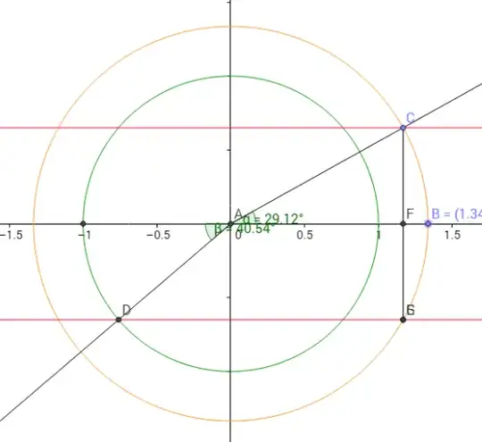

This might be a little trivial, but...
$n_1,n_2$ are the radius of the circles. The horizontal red lines are equidistant from the horizontal axis.
Interactive graph in GeoAlgebra, here: http://tube.geogebra.org/student/m771807
You can play by moving the point $B$ horizontally (hence changing $n_1/n_2$) and moving the point $C$ over the circumference (changing the incidence angle).
leonbloy

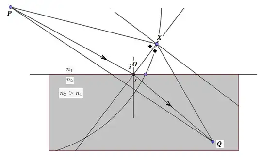

Yes, right. When entering a denser medium light slows down.. Adding another answer keeping only to the construction method. Drawn on Geogebra, removed the axes and grid to trace a ray inside a medium of higher refractive index $\mu$.
Choose an arbitrary point X such that
$$ \mu= \dfrac{XP}{XQ} \left( =\dfrac{n_2}{n_1}=\dfrac{v_1}{v_2} \right) $$
which is possible using Ruler & Compass using suitable segment lengths.
From $X$ draw bisector to angle $PXQ$ cutting interface at $O,$ which is the required point of incidence. Due to refraction, the point of incidence $O$ always shifts to the right, when stat point $P$ is at top left, compared to the straight unrefracted ray $PQ$ point of impingement on interface.
The ratio of sides and times spent in each medium is maintained due to the constant bisector property of Apollonian Circle ( no need to draw it).
